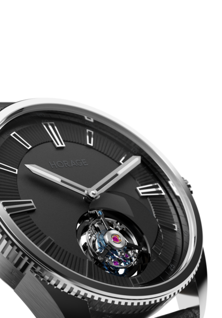

At 41mm in diameter and a thin 10.3mm profile, the case is stunningly proportioned. The lug-to-lug of 49mm combined with the case dimensions make for a very comfortable fit for the majority of wrists. Grade T5 titanium (Ti 6AI-4V), as used in the Lensman 1 case and crown is a premium titanium alloy comprised of 90% titanium, 6% aluminium and 4% vanadium.  This Grade 5 titanium is very lightweight and the reduction in case weight makes for wonderful wearing comfort on the wrist. Another important detail of working with T5 is the ability to achieve an incredible polish with a pure and clean metallic look. Brush decoration work with T5 is superior over T2, which is the typical titanium used by other watch brands.  The resulting case finish on Lensman 1 is nothing short of impeccable.
The aesthetic of the case is inspired by a manual focus camera lens. The body is laser etched with the markings of an f/0.95 aperture ring. An f/0.95 lens is rare and anything under f/1.0 is among the fastest lenses in the world. By fast, it means it allows the most amount of light through the lens to the camera, making it more capable of exposing subjects in lower light. A byproduct of this big aperture is the beautiful shallow depth of field called bokeh which is often found in portrait photography. Shallow depth of field is a narrow/shallow area of an image that is sharp with the rest out of focus, the quality and structure of the out-of-focus area is bokeh. A shallow depth of field draws your eye to what is in focus, the subject, just like a tourbillon cage pulls your eye into the movement. To round out the look of the case is a fixed bezel that‘s reminiscent of a lens‘ focus ring.
THE DETAILS
The black dial with black HORAGE logo and black Swiss Super LumiNova® appliques and the option of a black stitched leather strap pay homage to pro photographers who black out their camera details. The diamond-cut hour and minute hands are packed with white Super-LumiNova® that glow green to improve legibility against the black dial.  The push-pull crown is finished with black onyx.
The focal point of Lensman 1 is naturally the cyclops magnifier that sits atop the titanium flying tourbillon at 6 o’clock.  The magnification heightens the draw of the tourbillon on one's eye. A five-layer anti-reflective sapphire crystal protects the dial to ensure optimal legibility in daylight as well as when photographing your watch.
Turning to the case back, the movement itself is finished in black PVD to complement the dial. "One's head, one's heart and one eye on the same axis" is engraved on the case back ring.

Reducing a tourbillon's weight and optimizing moving parts is the "pièce de résistance" for movement engineers. As performance watchmakers, our team has engineered the K-TOU calibre with this in mind. At just 0.29 grams the titanium tourbillon cage is one of the lightest cages in the world. It's a marvel of micro-mechanical engineering considering that 34 parts comprise its thin 3.4mm and 11.6mm diameter.
Contributing to the cage's lightness are the anti-magnetic silicon escape wheel, anchor and hairspring. The top bridge of the tourbillon cage has a blued screw that can double as a second indicator.
This hand-wound calibre has a beat rate of 25,200vph or 3.5Hz and delivers an astounding +120-hour power reserve (5 days) via a single barrel. Aside from just three parts, those being the silicon components that are made in Germany, everything that makes up the K-TOU movement is engineered and manufactured in Switzerland. K-TOU is accurate to chronometer standards (-4/+6 seconds per day).

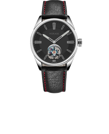

Dimensions / 41mm diameter, 10.3mm thin, 49mm lug-to-lug, 22mm lug width
Movement / K-TOU hand-wound flying tourbillon, titanium cage at 0.29 grams and 3.4mm thin, anti-magnetic silicon escapement inclusive of anchor, escape wheel and hairspring, chronometer accuracy at -4/+6 seconds per day, 19 jewels, 3.5 Hz (25,200vph), 120+ hour power reserve (5 days), blacked out aesthetic on movement main plate. Blued seconds indicator screw on tourbillon cage.
Case / Grade T5 titanium - hand polished and brushed, laser etched with camera lens aperture on case profile, fixed bezel inspired by camera lens focus ring.
Case back / Exhibition double layer anti-reflective sapphire crystal, engraved with "One's head, one's heart and one eye on the same axis."
Crown / Screw-down Grade 5 titanium with black onyx inset stone.
Dial  Crystal / Domed sapphire with multi-layer internal anti-reflective coatings, round cyclops magnifying lens over flying tourbillon aperture at 6 o’clock.
Water resistance / 100 meters.
Dial / Black with black gold applied indices, black Super-LumiNova® luminous inserts, flying tourbillon at 6 o’clock, 60-minute track
Hands / Diamond cut hour and minute hands with Super-LumiNova® luminous inserts
Straps / Black or red stitched hand/Swiss Made calf leather with camera body-inspired texture and Horage's proprietary deployant buckle.
Weight / 44 grams watch only.  64 grams with watch, strap and buckle.
