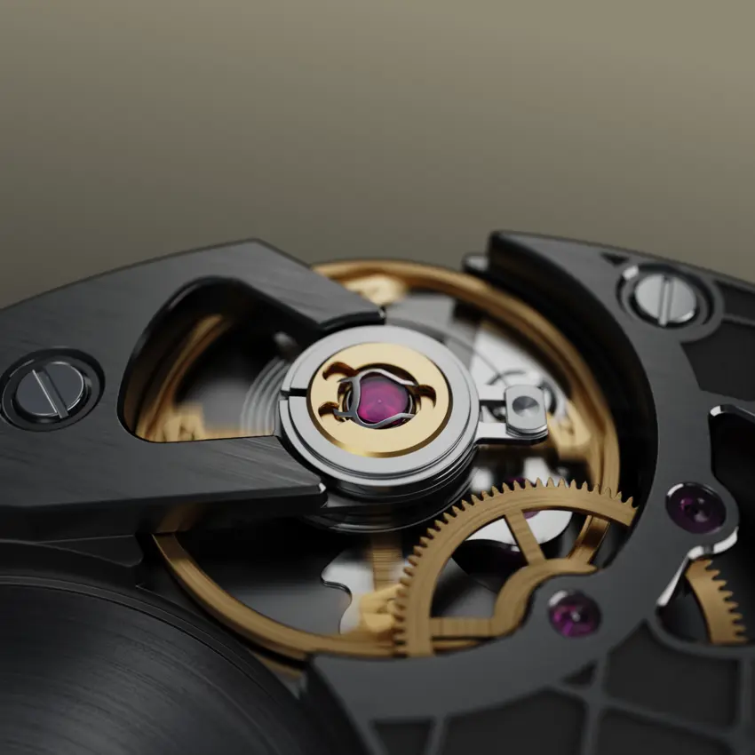

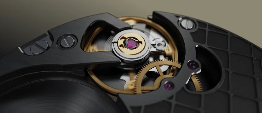

They’re much more difficult to design and perfect than standard automatics that have larger external rotors. Introduced in the late 1950s, micro-rotors are integrated within a movement instead of sitting on top, allowing for a thinner overall package and better view of the mechanics. There are downsides, however, which again limit the scale of production and increase prices. For starters, the smaller rotor has a lower rotational inertia, making it harder to adequately wind the mainspring, but through modern engineering these challenges can be overcome.
A heavy, dense metal must be used such as tungsten or precious metals like gold or platinum. Tolerances must also be exacting for everything to perfectly synchronize and provide both a COSC level of accuracy and adequate power reserve.
We’re talking around 0.1-0.2 microns!
A human hair starts at around 17 microns. In addition, we’ve designed an ultra-efficient mainspring that’s more pliable than the norm. This has increased the movement’s winding efficiency by 55%, allowing for a 72-hour power reserve that actually surpasses most other highly industrialized single barrel Swiss automatics.

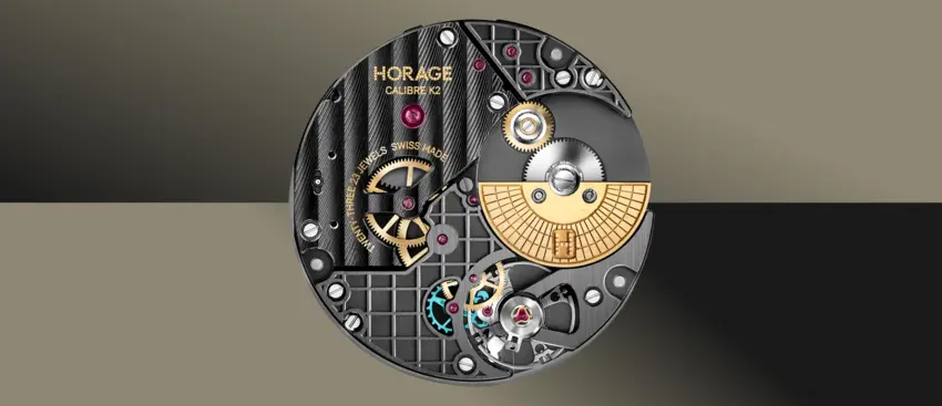

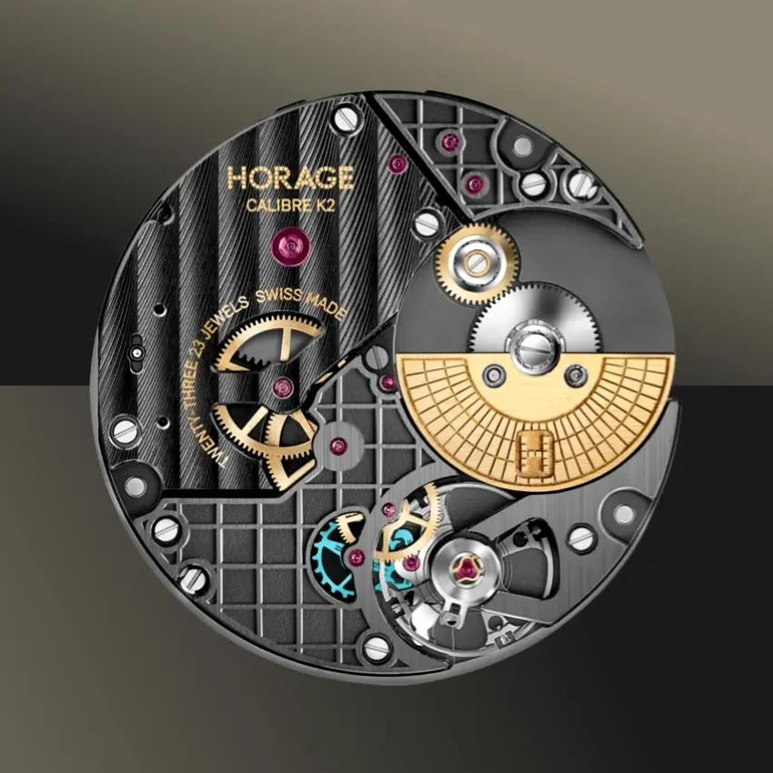

As a performance movement that sits between manufacture and industrial counterparts, K2 sports impressive and unique decorations. It's finished with black gold plating and yellow gold lettering, Côtes de Genève on the main bridge, anglage edging and key cutouts that show deeper areas of the movement. The grid pattern is a signature design element and was inspired by the HORAGE logo. Decorations including Côtes de Genève, brushing and anglage are all hand finished. The micro-rotor itself is gold plated tungsten with laser etched tiles resembling the HORAGE logo, and has hand brushed and polished surfaces.  Along with gold plated tungsten we also explore precious metal usage depending on the watch project. The movement has 25 jewels and many contrast well against the black background, providing a futuristic vibe.
