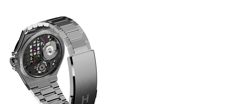

At 3.6mm the K-TMR calibre is svelte yet powerful, with 72 hours power reserve.
Through advanced gear train geometries, a full non-magnetic silicon escapement and optimized micro-rotor weight, the K-TMR is not only the newest proprietary Swiss micro-rotor tourbillon but one of, if not the most efficient micro-rotor tourbillon calibres available today.
To build the future you need to go above and beyond what is ‘normal’ today. Through advanced engineering, HORAGE has once again raised the industry bar and has placed the K-TMR in a league of its own for many years to come.
RHODIUM PLATED TUNGSTEN OR PT950 PLATINUM
Rewinding efficiency is at the core of any micro-rotor movement development.
Maximum rewinding efficiency is critical and the HORAGE engineers have used a Rhodium-Plated Tungsten micro-rotor for this task.You can choose to upgrade to PT950 platinum for an upcharge at point of order.
Tungsten is a dense metal and is the industry option for micro-rotors. Increased material density causes the rotor to swing and initiate the rewinding of the mainspring at lower angles.
This means smaller wrist movements will cause the rotor to oscillate and thus rewind your watches power reserve faster. The PT950 Platinum upgrade offers an even higher level of density. A premium precious metal option, which further increases the winding efficiency by an astonishing 8%.

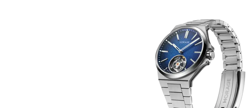

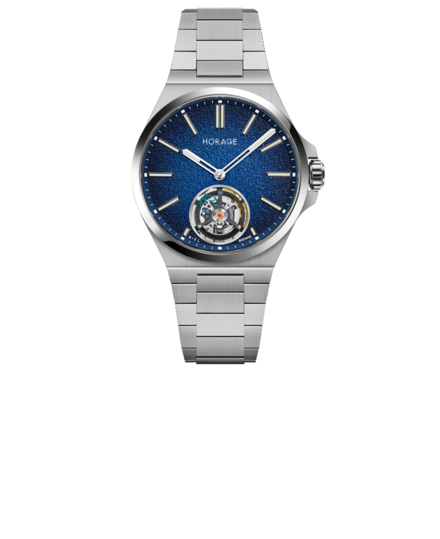

Autark Tourbillon
Galactic Blue

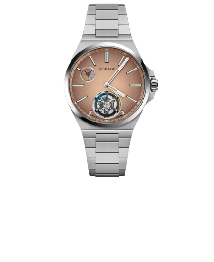

Autark Tourbillon
Salmon Dial With Power Reserve

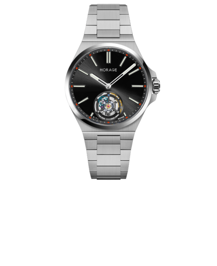

Autark Tourbillon
Sunray Black Dial
