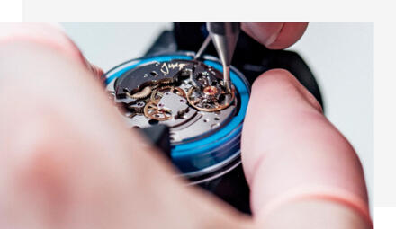

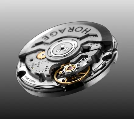

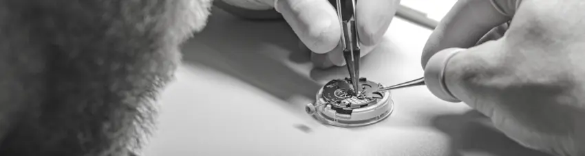

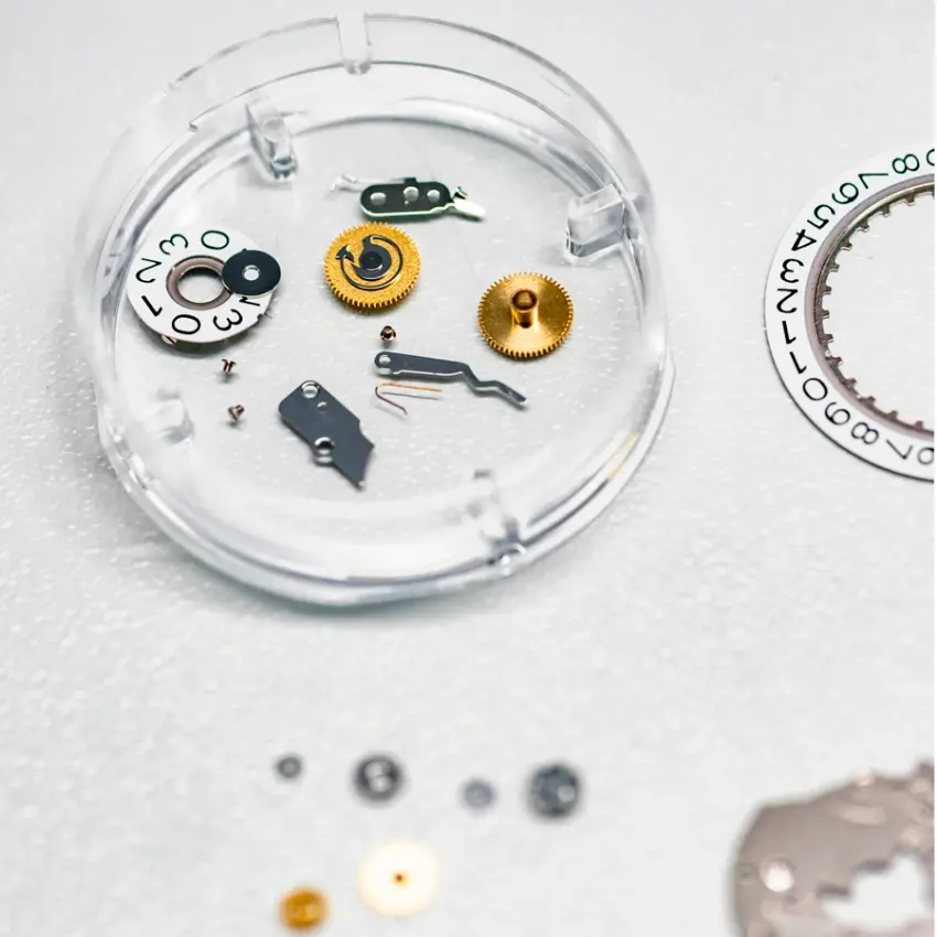

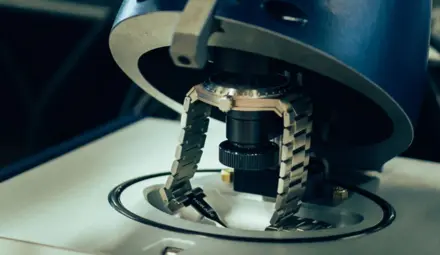

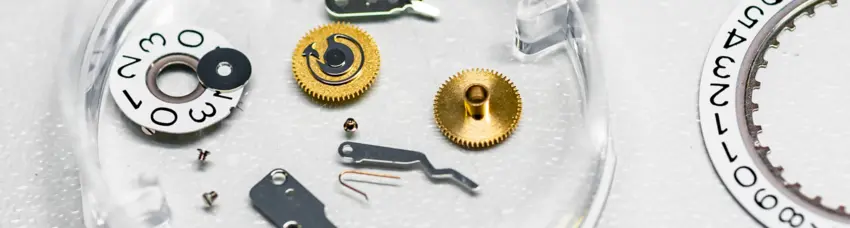

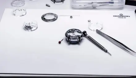

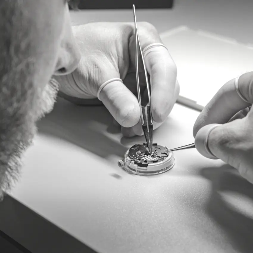

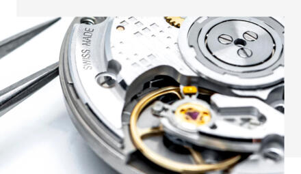

SERVICE STEPS
Here are the steps we take when servicing your watch

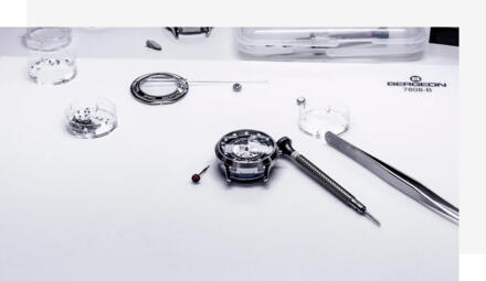

1. Watch Disassembly
/ Bracelet or strap is removed from case
/ Case is completely disassembled

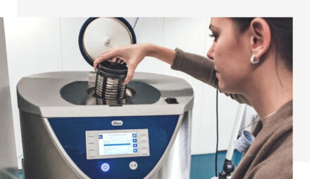

2. Movement
& Parts Cleaning

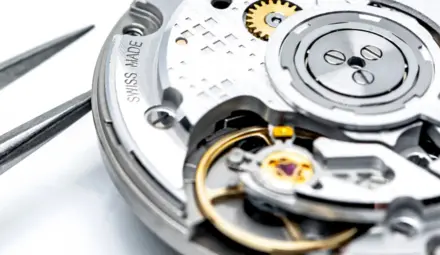

/ Movement is disassembled
/ Each component is treated to an ultrasonic bath
3. Replace
& Retro-Fit
/ Any worn movement parts are replaced
/ Any part updates are retro-fitted
4. Movement
Re-assembly
/ A complete movement re-assembly
/ Lubrication applied where necessary

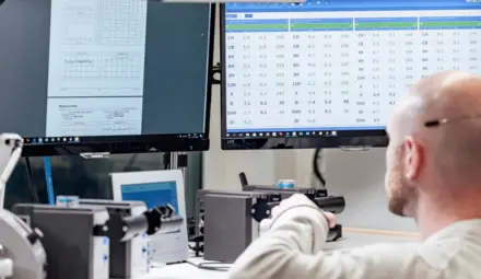

5. Adjustment
& Accuracy

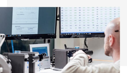

/ Adjustments made to 6 positions
/ Each position is measured for accuracy
/ Atomic watch synchronization then Cyclone test at 1rpm for 24 hours
/ Full power reserve testing over 3 day period
6. Case &
Bracelet Cleaning
/ Full cleaning of case and bracelet prior to re-assembly
7. Water Resistance Testing
/ All seals/gaskets replaced and final casing completed
/ Water resistance test conducted for model specified resistance

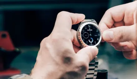

8. Final Quality Control
/ The fully assembled watch completes a stringent final visual analyses
9. Packaged & Shipped
/ Watches are vacuum sealed in a protective cover
/ Original customer packaging used whenever possible to reduce waste and additional protective packaging added if necessary
