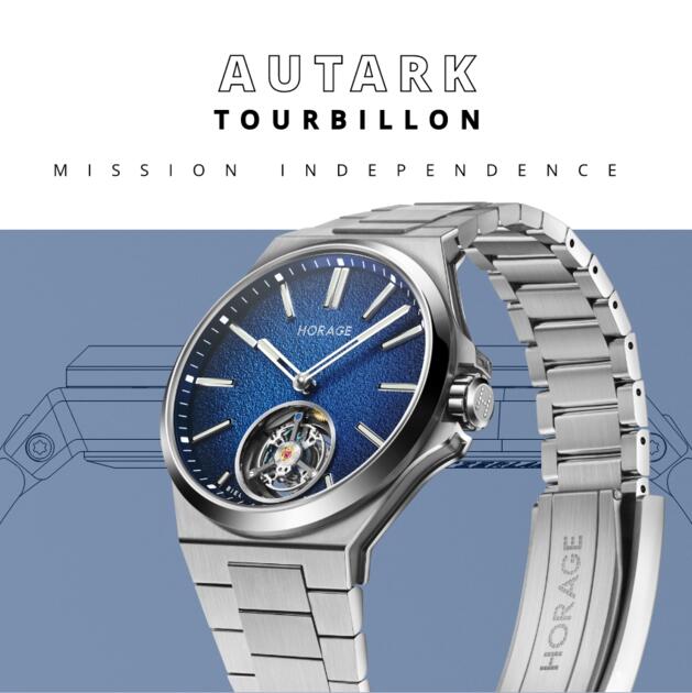

AUTARK TOURBILLON
Cues were taken from our earlier generation Autark timepieces.
The complex, multi-layer and sub 9mm thick case construction is simply stunning but proved to be a challenge in production. With its mix of polished, brushed and ceramically abraded Grade 5 titanium surfaces the case and bracelet offer a fascinating kaleidoscope of textures and hues.
DIALING IN THE DETAILS
Sporty, mesmerizing depth was a prime focal point for the Autark Tourbillon dial.
Setting the mood to the functions and finish of the micro-rotor tourbillon are the choice of different dials. Stamped Gradient Grey, Sunray Black, Galactic Blue and Salmon.
At 6 o ‘clock the 0.29-gram titanium flying tourbillon whirls and captivates as it makes a full rotation every 60 seconds. A blued screw in the cage references the seconds and can be marked at the 30-second point of the minutes track that circumnavigates the dial.
Champagne gold or bright rhodium finishing on the tourbillon cage aperture create a visual separation that complements the hour markers, which are filled with Swiss Super LumiNova®. At 10 o ‘clock on the Gradient Grey and Salmon dials
BRACELET& MICRO ADJUSTMENT CLASP
A captivating interplay of brushed and polished surfaces
Refined detail and proportion were paramount for the integrated Grade 5 titanium bracelet. A taper from 22mm to 16mm perfectly balances between sporty and elegant.
The beautifully crafted bracelet is fastened with HORAGE’s proprietary HMAC micro-adjustment buckle, which offers 10mm of adjustment in 1mm increments.

SPECIFICATION
Thin & Comfortable
Sub 9mm thick & 39.5mm case diameter
Water Ready
100 Meters water resistance
Packed With Power
72 Hours / 3 Day Power Reserve
Titanium Tourbillon Cage
The 0.29 grams titanium flying tourbillon makes a full rotation every 60 seconds.
Functions: Titanium flying tourbillon, hours and minutes, option of with or without power reserve indicator (PR indicator only available with Gradient Grey & Salmon dials).
Movement: K-TMR micro-rotor tourbillon, 3.6mm x 30mm, 72-hour power reserve, silicon spring & escapement, screw balance regulation, hand-finished bridge work.
Colour: Anthracite Grey.
Micro-Rotor: Rhodium Plated Tungsten or upgrade to PT950 platinum.
Power Reserve: 72 Hours / 3 Day Power Reserve.
Cage: Titanium flying tourbillon, 0.29 grams, 43-piece construction, silicon pallet fork, escape wheel and hairspring.
Dimensions: Diameter 39.5mm, thickness of sub 9mm, lug to lug 48.3mm, lug width 22mm.
Case & Crown: Grade 5 titanium, crown guards.
Dial: Gradient Grey (PR), Galactic Blue, Sunray Black and Salmon (PR) with Swiss Super LumiNova® appliques that glow green, 60-minute track.
Hands: Centre hour and minute hands, blued seconds indicator on the tourbillon cage.
Bracelet/Strap: Grade 5 titanium integrated bracelet that tapers from 22mm to 16mm with 10mm micro-adjustment buckle in 1mm steps.
Crystal: Multi-layer anti-reflection sapphire crystal.
Case Back: Sapphire crystal.
Water resistance: 100 Metres.
