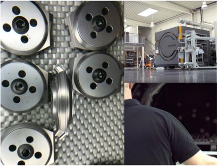

UTARK Titanium grade 5 cases after hardening in Denmark

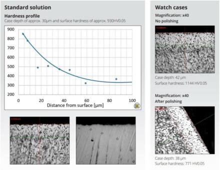

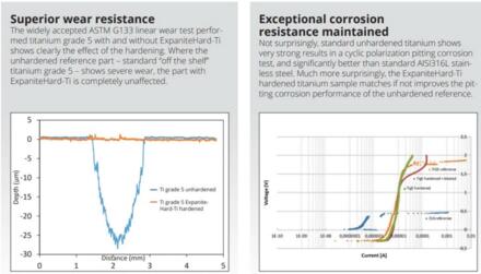

This hardening oven is located in Denmark and operated by our partner Expanite, who developed this specific gas-hardening process for grade 5 Titanium. In fact, this hardening technology is NOT a hardening in the sense of surface coating, or alternatively as it is often done with steel by using a combination of hot and cold liquids. It is a gas-based hardening process in which the material is heated to open the metal matrix and during this process infuse various gas molecules to strengthen the outer layer of the Titanium to a depth of approx. 40µm. This means the hardness does not sit outside on top of the Titanium, it much more has infiltrated the material itself.
Imagine while heating the material the metal matrix is opening up and gas molecules go in between atoms of the Titanium alloy and once the material is cooled back down, these gas molecules increase the strength because the tension in between the Titanium alloy matrix has been increased. More atoms of various properties squeezed in a smaller space. Kind of simple…
Why can things go wrong? If you do not understand the process flow and strictly stick to the recipe this increase in tension can twist parts and move things out of tolerance. Sometimes things like this happen and nobody knows why… There is a bit of "praying" involved that the parts come out as we wish them to be. It is highly recommended once the right formula has been found, to never change something again, especially not the material supplier...To further control these tensions, we must clamp the cases into special toolings to hold them together during the hardening process as you can see in the picture two.
