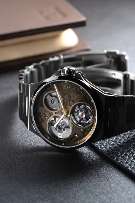

Into this world we release a new bubble: Autark Tourbillon Bubbles, a product which has been many years in the coming. It was a forgone conclusion that after releasing a micro rotor calibre and a hand-wound tourbillon that we couldn’t resist the temptation to put them together. Back in 2023, the resulting mechanical engine: the K-TMR was the perfect power source for the latest model in our Autark series: Autark Tourbillon was a logical next step in the HORAGE story.
Combine horological excellence with space-age materials to create an instant, modern classicA watch which isn’t packed with timekeeping complications: instead, our focus was on delivering a tourbillon and micro rotor combined in one piece. Is the tourbillon a ‘real’ complication – let's not restart this discussion! We know that for us as watchmakers and for many fans it is the most desirable achievement in mechanical watchmaking and an aspiration for many collectors.

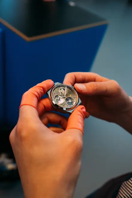

What we never previously told the community until now is that the watch we originally wanted to release back in 2023 is the Autark Tourbillon Bubbles. Turns out however that inverting your engine by 180° is a little bit more of an engineering challenge than we originally thought! Well, you learn by trying things out, making mistakes and then implementing your new knowledge, right? Suffice to say, we learnt a lot during this project.
Where should we start?
Firstly, we realised that this piece would take longer. Our focus switched to the Autark Tourbillon in the ‘conventional’ layout. ‘Bubbles’ as it became known within the company would be developed and engineered in parallel but with an undefined, future release date.

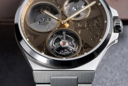

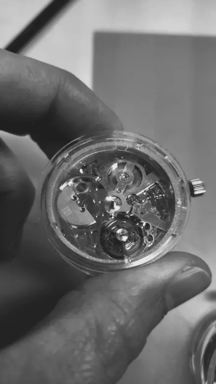

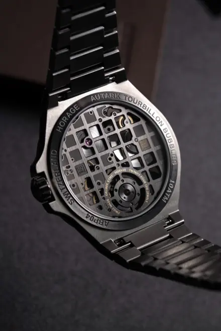

Secondly, when you flip one part oversignificant number of other elements must change too. A micro rotor at the front of the calibre rewinds the mainspring in the other direction! So, the ratchet and complete winding mechanism need to be adapted. In a normal construction the 3 ‘core’ elements of micro rotor, tourbillon and mainspring are distributed over 2 different sides of the bridge plate. Fit them on one side and….well, no surprise they don’t and can’t fit! The diameter of the whole movement must increase. In a normal movement key fastening locations are obscured by the dial: in ‘Bubbles’ they would be visible and therefore also needed to be relocated
Don’t forget: one of the secrets of our ability to offer so much horological bang for your precious bucks is the philosophy of using as many standardised components as possible across different models (in some cases we have achieved 80%). Flipping the movement meant throwing this this rule out of the window.
Thirdly: there is a big difference between creating a construction which works perfectly in OnShape, our favourite 3D modelling software and one which is manufacturable using the available machines in our small but well-equipped factory! Our production team had to apply out of the box thinking to physically cut the calibre main-plates and bridges to the required tolerances using CNC cutting tools just 0.5mm thick. This is close to the limit of current reductive manufacturing capabilities.
Of course, not every part can be manufactured within our own factory. Like every watch brand we also depend on our close relationship with specialist external suppliers. A good example for our ‘Bubbles’ baby is the translucent glass ‘dial made in in Lausanne by GB Microfab. This gives an uninterrupted view to the K-TMR 2 calibre, which has additional open worked sections in and around the three ‘bubbles.’ The metal frame surrounding each bubble was a further manufacturing challenge. It is made using the LIGA galvanic growth process, which allows the extremely high precision and high aspect ratio necessary for this part (eagle eyed readers will remember we also use LIGA tech to make certain geartrain parts for our GMT complications). Cutting the 3 bubbles in the nano-coated glass dial is a critical and technically complex task to produce the dial successfully.
