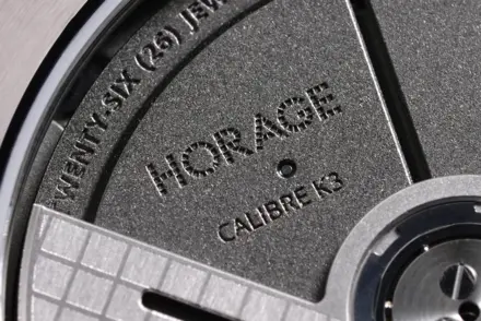

If the K3 calibre becomes widely available to other brands, Horage moves beyond being a watchmaker into a technology provider.
Is this a deliberate step towards a role that could challenge the historical position of suppliers like ETA or Sellita?
Andreas Felsl:
K3 is among the highest‑performing movements available. Whether other brands adopt it remains to be seen. We do not aggressively pursue OEM business — it is difficult, and many brands undervalue movement development while overspending on marketing.
K2 and K3 form the foundation for MicroReg, which could challenge the entire movement industry. The key question for us is strategic:
Do we remain a premium‑segment innovator, or do we build a monopoly‑level technology platform that could dominate Swiss, Chinese, and Japanese movement production?
MicroReg forces us to consider these possibilities seriously.

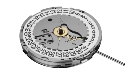

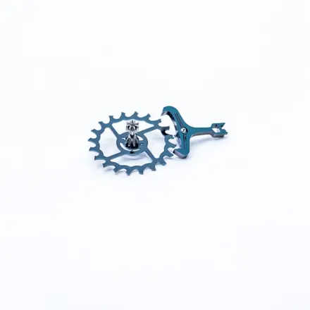

17. Internal vs. external development of key movement elements
WoW:

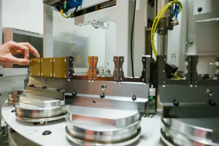

If we break your movement down into its key elements – the regulator (balance and hairspring), escapement (anchor and escape wheel), gear train and power system – which of these do you fully design and develop internally, and where do you still rely on external suppliers or know-how?
Andreas Felsl:
We design, lay out, and engineer every key element of our movements. The intellectual property behind the architecture is entirely ours. Where we rely on suppliers, it is limited to highly specialized process know‑how — for example coatings, technical surface treatments, or other niche processes where Switzerland already has world‑class specialists.
Most companies claiming to have their “own” movement are in reality building on ETA architecture and using off‑the‑shelf components for the most difficult parts: ratchet wheels, friction systems for hands, setting mechanisms, and especially the entire assortment. Many do not understand the mathematics behind the gear train, tooth geometry, force distribution, or any of the fundamentals required to claim true authorship or improved performance.
This is the real skill of movement making: controlling the core IP in design and process know‑how. It is not about owning machines; it is about understanding every step that leads to a reliable, high‑performance movement.
We control all fixture and toolmaking relevant to T0 and T1 assembly processes. We never buy finished sub‑assemblies (such as riveted wheel‑and‑pinion units) unless we have a long‑standing relationship with a supplier who fully understands our requirements and gives us complete transparency into their own supply chain.
The reason is simple: when you innovate and improve a movement, you must be able to debug it. If you do not know every process step behind a sub‑assembly, you cannot identify the source of a problem. At this small micron-level scale, even an incorrect washing process can cause a movement to fail.

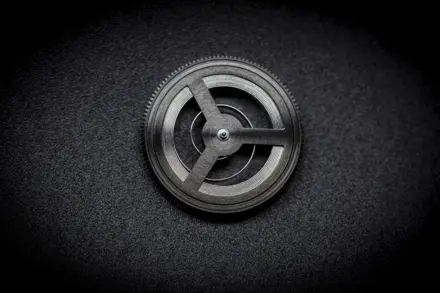

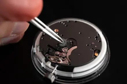

18. Control over the regulator and hairspring
WoW:
Focusing on the regulator, meaning the balance and especially the hairspring – do you have full control over their design and parameters, or do you still depend in any way on external solutions or expertise?
Andreas Felsl:
For the hairspring, we work with an experienced mathematician who provides the theoretical foundation. We then translate those numbers into a functional 3.5 Hz system. For the escapement, we now perform all mathematical work internally, same for laying out tooth shapes. Since 2011, we have gone through more than eleven improvement iterations on our escapament, and that accumulated knowledge feeds directly back into our simulations, geometry, and process optimization.
In the early days, we did not fully understand the mathematics behind the escapement. Today, we combine deep theoretical understanding with more than a decade of practical experience.
One clarification: one of our shareholders, Florian Serex, is part of our development team and acts as our primary simulator. He works on a contract basis, but after 15 years of collaboration, we consider this in‑house. In complex product development, external theoretic expertise is always part of the equation. Even car manufacturers rely on tools like KISSsoft for gear design, which means they depend on external algorithms and historical data libraries.

No one in this industry invents everything from scratch. For example, our escapement architecture was inspired by a 1968 Tissot patent from the era when plastics and micro‑injection molding were entering watchmaking. We took the geometric idea and transformed it into a version optimized for silicon. Many of our components draw inspiration from historical solutions — that is how engineering evolves.
But when you look at our component toolkit — System‑K — which is entirely based on our proprietary engineering and modular architecture across five calibers, then the entirety of the IP is ours. We know how to design, engineer, source, quality‑control, manufacture, assemble, and service all of our movements and their parts. At this level of variety and performance, only Rolex and ETA can claim something comparable.
Consider Breitling and Universal Genève. Why did Breitling ask Sellita to industrialize the B31? Why did they ask LTM to handle Universal Genève movements? And why do none of these movements use silicon? Because Breitling can manufacture the B01 — designed by former engineers who also worked on the Daytona — but since then, they have not brought a fully proprietary, high‑performance movement to market. Because they have not team internally which can design industrial movements from the ground up.
There is a huge difference between manufacturing something that has already been designed and de‑risked, and designing something from scratch. Very few people in the world can design an industrially producible movement more or less from blank page. We have several of them in our team, with experience spanning Omega Cal. 8000, the Vaucher micro‑rotor, the Eterna Cal. 39, Richemont ValFleurier and La Joux‑Perret calibers, and our own K1, K2, K3, K‑TOU, KT‑MR — plus another industrial movement that will be revealed in 2026 by a Swiss company.
