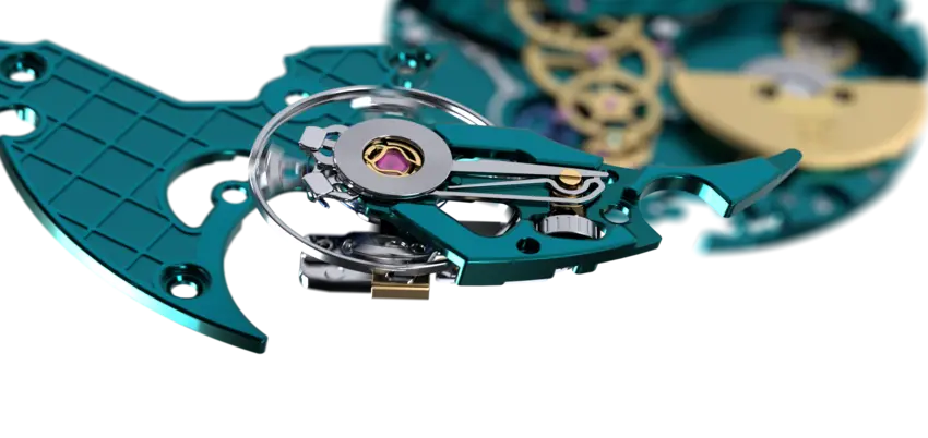

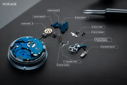

Working closely with our technology partner miniswys SA who are a spin-off of the legendary Biel-based innovation company Creaholic. Its core technology is based on a miniature actuator designed by Elmar Mock, the inventor of the Swatch watch.
This miniature actuator requires just two elements, a ceramic and a metal carrier. It requires no coils, magnets or chips inside the watch and very little energy, as its power consumption at standstill is zero. Its service life is almost infinite thanks to the materials used and their processing.
With the ultra-thin miniature motor, miniswys enables Horage to produce a Swiss mechanical precision watch with unrivalled accuracy. In future, any high-quality Swiss watch fitted with a miniswys actuator can be set forwards or backwards to suit the individual wearer in tenths of a second increments with a simple tap of the finger.
Watchmakers, and importantly watch owners themselves, can perform adjustments to the watch in a timely and accurate manner, without opening the watch case.
MICROREG IS REGULATIONS SILICON
Just as Silicon technology brought the watchmaking world the technological leap for escapements, Horage and Miniswys’s MicroReg technology promises to give the field of movement regulation it’s 21st century technological leap.
How does it work in simple terms?
Simply put, there is a ‘sleeping watchmaker’ residing inside your watch. When adjustments are required to the regulating organs of the watch, it can be ‘woken’ to allow adjustments to be performed, with adjustments being made as small as 0.1 seconds.
All this is possible without opening the watch case, and with access to the adjustment tool it can be performed quickly and easily in any location, by anyone with the correct knowledge.
With everyone being different and use cases being so varied, each watch equipped with MicroReg technology will allow for quick and easy personal regulation, to ensure their mechanical watch runs as close to zero deviation as is possible.

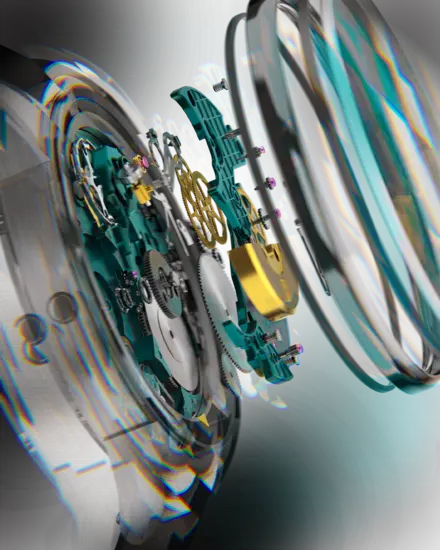

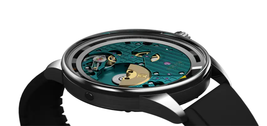

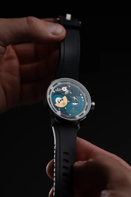

We start with our in-house K2 micro-rotor movement and integrate our new MicroReg technology. The K2 has strength and endurance with 72 hours of power reserve with one of the most efficient winding rotors in the industry, the K2 is already a benchmark for modern movement engineering, the addition of MicroReg Technology further elevates the K2, now allowing a level of regulation finesse not before seen in a Swiss mechanical watch.

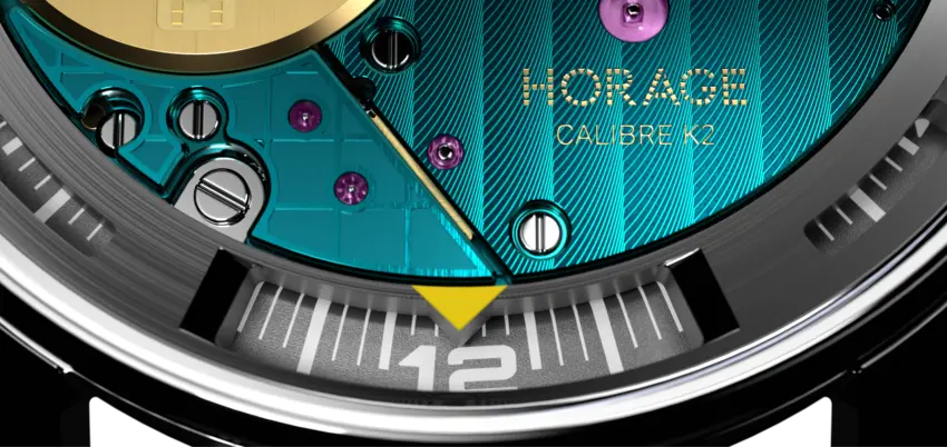

We decided to let the movement and the MicroReg technology do the talking, and literally inverted our thinking of how to present this. The movement is front and centre!
In another first for Horage the main time display is presented on a rotating disc, with time indication read at the 6’o’clock position with excellent legibility at night assured with Swiss Super LumiNova®. Everything protected by a sapphire crystal with multiple anti-reflective coatings.
Water resistance of 100 meters adds protection and ruggedness for life’s adventures, while the sapphire exhibition case back displays the secondary time indication, with an hour disc and independent minute and centre seconds hands.

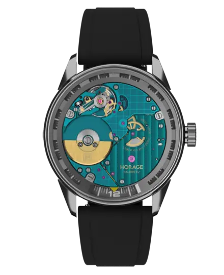

THE K2 MICRO-ROTOR
has become our mainstay calibre and is the most attainable in-house Swiss micro-rotor in the industry, featuring a gold-plated Tungsten rotor and a vertical brushing that matches the case. The addition of MicroReg technology boosts it’s feature set into the 21st century.
As the K2 movement featuring MicroReg is the star of the show, the movement is finished in a Peacock Blue colourway with our signature open grid pattern with anglage and Côtes de Genève hand finishing.
Adding to the resiliency and reliability are an anti-magnetic silicon escapement and hairspring, which is a rare combination for an independent watchmaker and increases overall efficiency and isochronism.

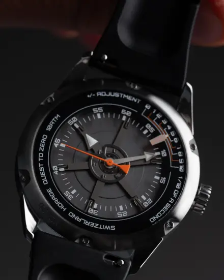

Revolution 3 MicroReg
Function: Time Disc on front face of watch with time shown in 5-minute increments. Hour Disc with Independent Minute and Centre Seconds hands on rear.
Case & Crown: 316L Stainless Steel, push-pull crown.
Dimensions: Diameter 41mm, Thickness 10.05mm, Lug to Lug 48.22mm, Lug Width 22mm.
Hands on Front Side of watch: Hour and Minute Disc with time shown in 5-minute increments. Numerals and 30-minute markers feature Swiss Super LumiNova® that glows blue.
Hands on Back Side of watch: Hour Disc with Independent Minute and Centre Seconds hands, Swiss Super LumiNova® marker triangles that glows blue.

Movement: Inverted K2 micro-rotor, 2.9mm x 30mm, +72-hour power reserve, silicon spring & escapement, screw balance and MicroReg regulation, hand-finished Côtes de Genève & quadratic bridges finished in a Peacock Blue colour featuring the revolutionary MicroReg technology.
Micro-Rotor: Gold-plated Tungsten.
